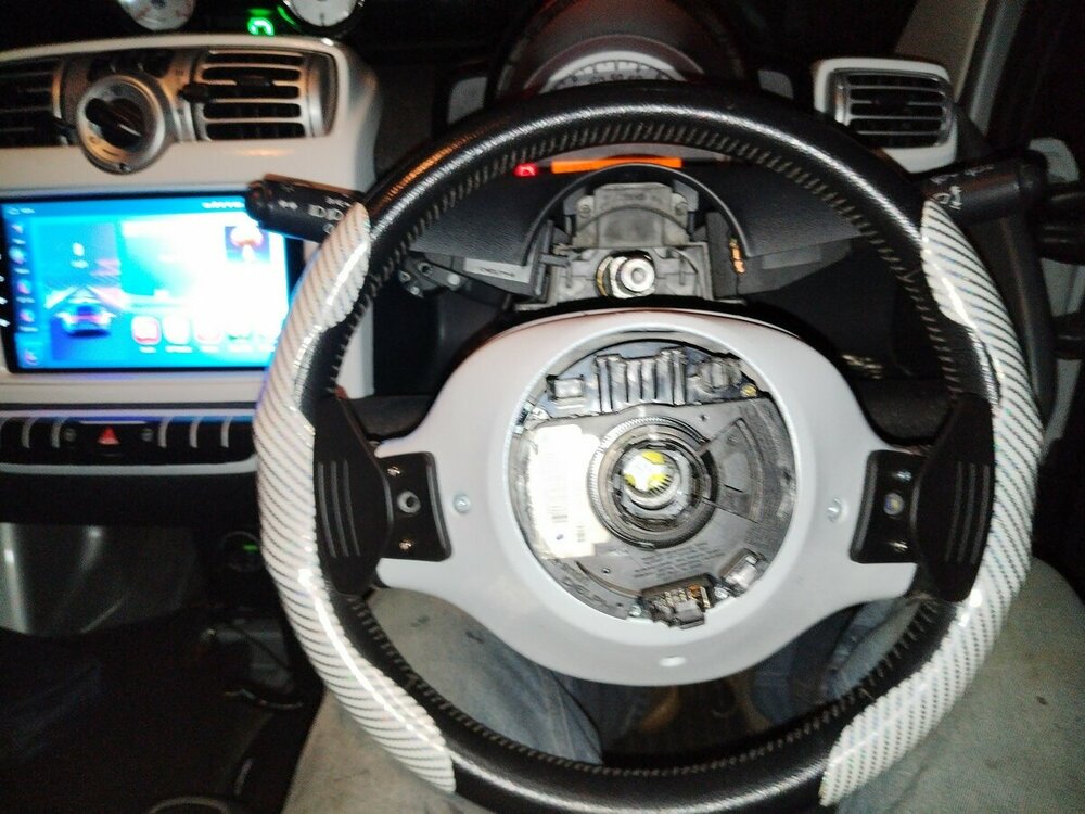

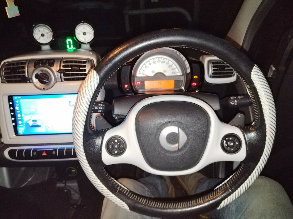

I have seen this other website Evilution, I am a paid for member there and I have been talking to Kane, the owner of the website about this paddle shift. Whichever system you try to use you are faced with great expense and some of the conversions also require programming at a cost of around £100. Then you have the added problem of finding a steering wheel which has the gear change paddle switches already fitted, I have been watching eBay and other websites for quite a few weeks and I've not found a suitable steering wheel. The conversion I have done does not require programming, It is done by using 433MHz remote control, the receiver and logic are mounted next to the SE Drive PCB and no wires need to be run up to the steering wheel. I designed a simple interface that prevents the gear change system from sending more than one signal back into the car, I wasn't sure how the car would react to receiving more than one signal. This interface simply copies the gear + and Gear - signals. The total cost so far is less than £25 for a working system. An earlier post here showed part of the SE Drive circuit, this wouldn't have been done by Mercedes, the schematic looks like it has been done using Eagle, a PCB design software, someone has reverse engineered the SE Drive circuit board. Whilst my system works, having the schematic would be useful to see if the idea can be simplified.
Is this a 451er Smart with a Diesel engine? 🤔
vor 7 Minuten schrieb Ahnungslos:
Is this a 451 Smart with a Diesel engine?  🤔
Yes it is the CDI 2009

I've only just painted the white parts this week. Black looked boring inside 😂
Would you please send Pictures with the Outside of the car! 😉
